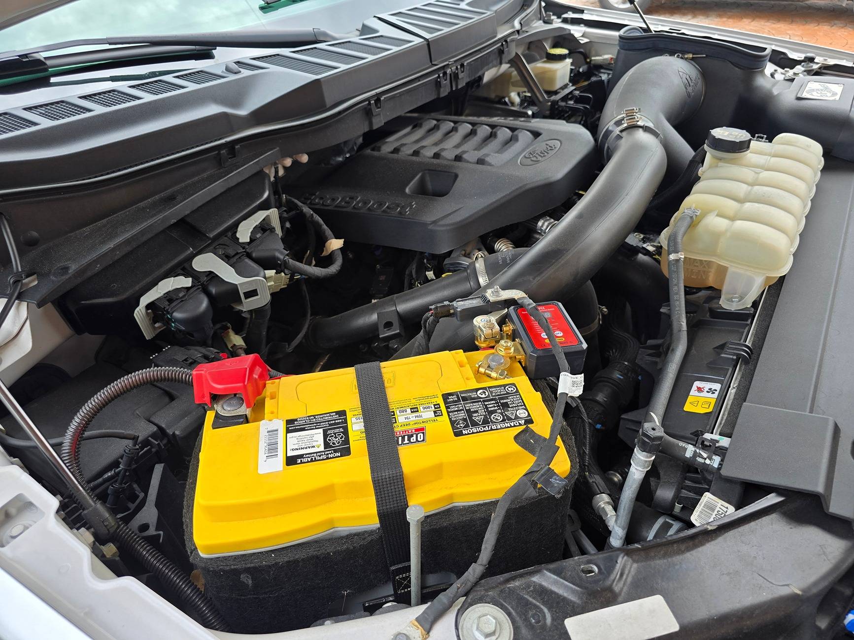

Off topic, but just wanted to post a follow-up regarding the battery cut-off switch I installed. It was super easy to do and even easier to use. I should have done it sooner.
