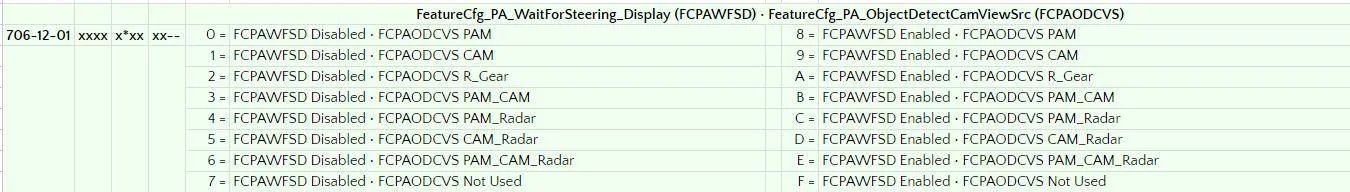

This is what you are showing in this line of your IPMA:
Ford F-150 Lightning Lightning Software Updates using FDRS 1729620059826-ux
After consulting with one of the guru's on the ICE forum and pulling the a/b data of another Lightning, I would change this to an 8:
xxxx x8xx xx--
xxxx x8xx xx--
As a confirmation mine is set to 8 and the front camera comes up but have to be pretty close. I usually just manually bring up the camera instead of waiting
xxxx x8xx xx--
This fixed it for me also, thank you!
