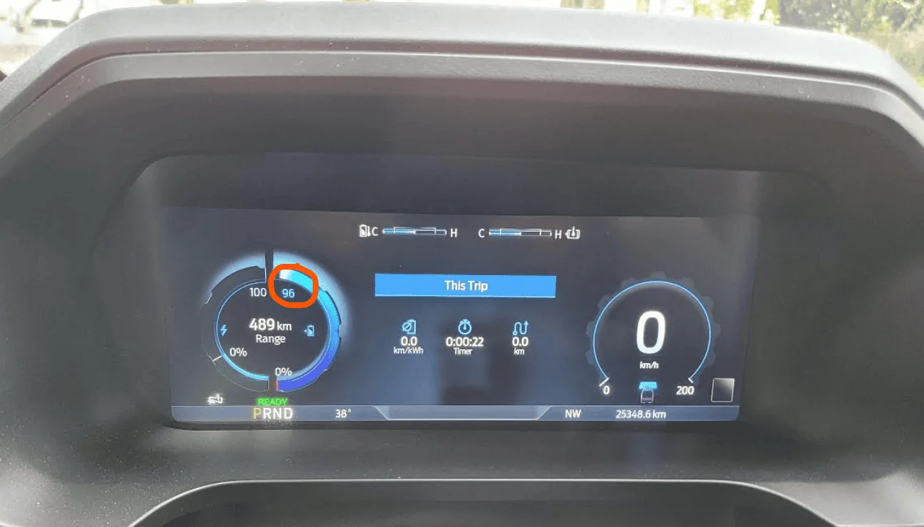

Update, I recieved the Power-Up 22-PU0930-RBA-CHM on July 25,2023
Ford F-150 Lightning Priority Update: 22-PU0930-RBA-CHM: Frunk Chime Vol, SOC digits 1690389140819
Percent charge now showing on Trip screens handy little addition. ;) (y)
I have to give Ford an "Atta-Boy" for this. We owners on this forum asked for this and Ford made it happen. There is hope that Ford is listening and responding to the other issues and requests presented here, too.
