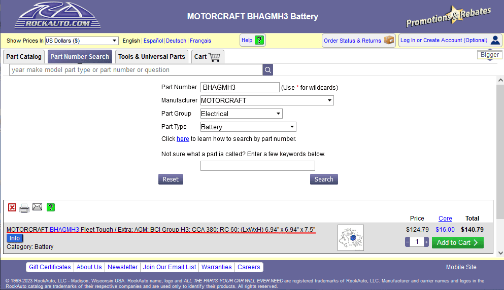

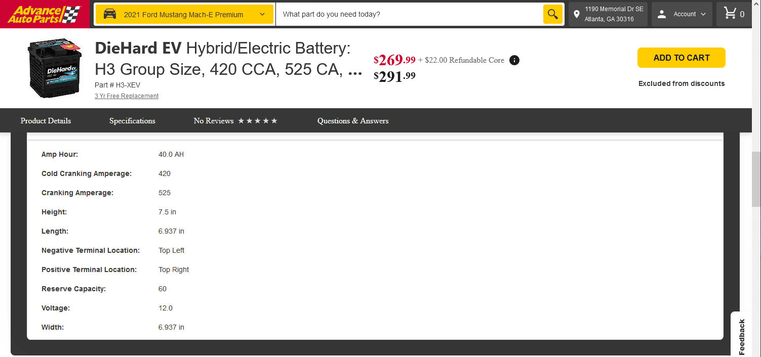

Well the 12V battery in the Mach-E and Lightning are the same 35Ah AGM battery. I think a lot of their problems could be solved by just going to a slightly larger capacity battery. It would mean that when 0100 rolls around and the default check update time logic looks for an OTA that the 12V battery might still show a SOC greater than 80% and the OTA would then process, instead of failing because of the battery.
Folks who aren't concerned with warranty replacements on their existing Ford supplied batteries in their MME or Lightning may want to consider this 40Ah DieHard replacement. I didn't realize until doing some searching around that the battery in our trucks and the Mach-E is a DIN H3 size.
Ford F-150 Lightning Priority Update: 22-PU0930-RBA-CHM: Frunk Chime Vol, SOC digits Mach-E-Lightning_Diehard_Replacement
The DieHard is made by a company called Clarios and apparently contains technology specific to the needs of EVs. Link Here. And Here.
Here's the exact replacement Motorcraft battery from RockAuto showing the specs, and size. If I needed a new battery I'd go with the DieHard.

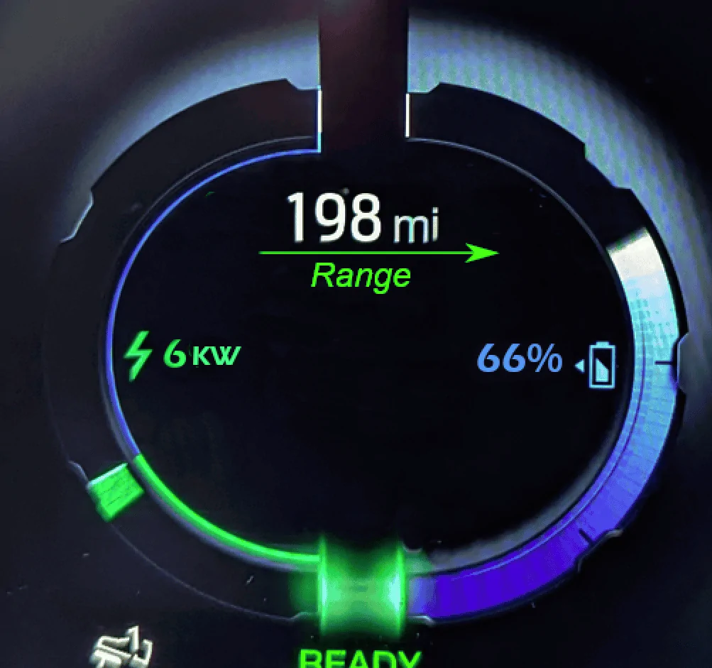

  • Next attempt, plug in truck, "UPDATE SUCCESSFUL Check out what's new!" Although, we're not going to tell you we added a little SoC reading that you've been wanting.

Overall glad to see the progress with Fords updates, which have for the most part been smooth for me. 3 big gripes resolved less than a year in.... 1) Camera button on main screen. 2) Better UI for HVAC and Temp Control on Seats 3) HVB SOC % now shown.
