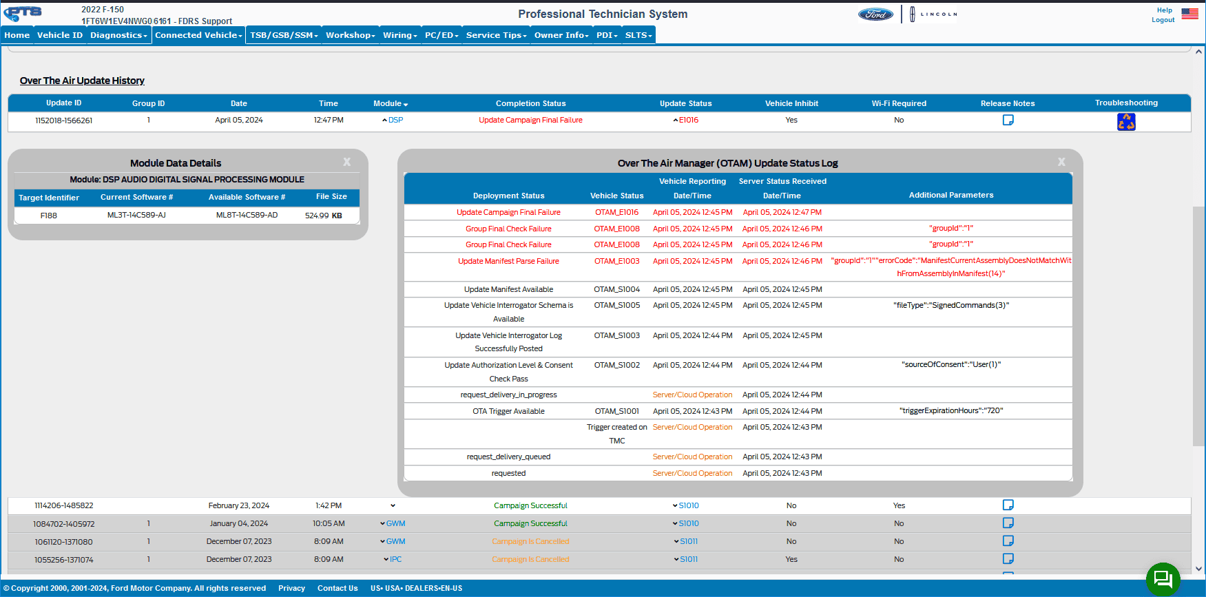

I love that the one and only time it was offered to me (today) it ends up with a "Final Fail". I know my DSP module doesn't like me after what happened last year. So at this point it's just f'ing with me. Apparently, it's personal.
Ford F-150 Lightning Software Priority Update: 23-PU1024-6CH-AUD - Refined Audio DSP-OTA-Fail
That's alright, I'll get the cable and laptop out tomorrow and we'll see what's what.

Ya, completely unrelated modules involved, I'm just speculating a post install reboot might help my situation.
I was intending to pull the negative cable this afternoon but then this update popped up, so if it's still not working correctly, I'll send another voice report.
Manifest mismatch. Something didn't match up between what you were getting sent and what you were supposed to get. FDRS will make quick work of it for sure.
