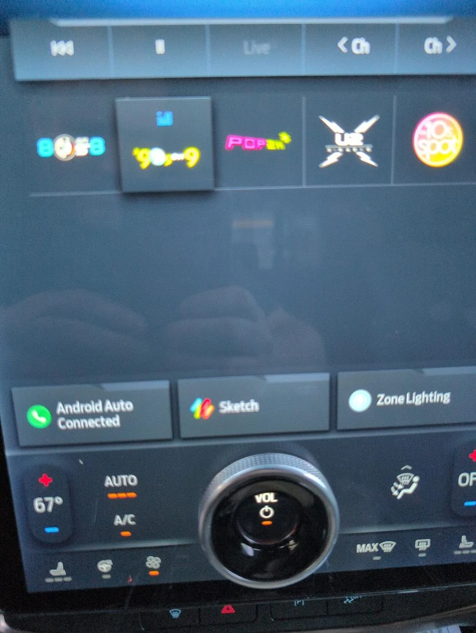

Anyone else lose all but the top row of radio presets? All I have now are five spots for radio stations. Worked fine yesterday and looks like my update was done overnight.

I haven't gotten the update yet, but you should be able to go into radio settings and adjust the number of displayed lines to fix this.

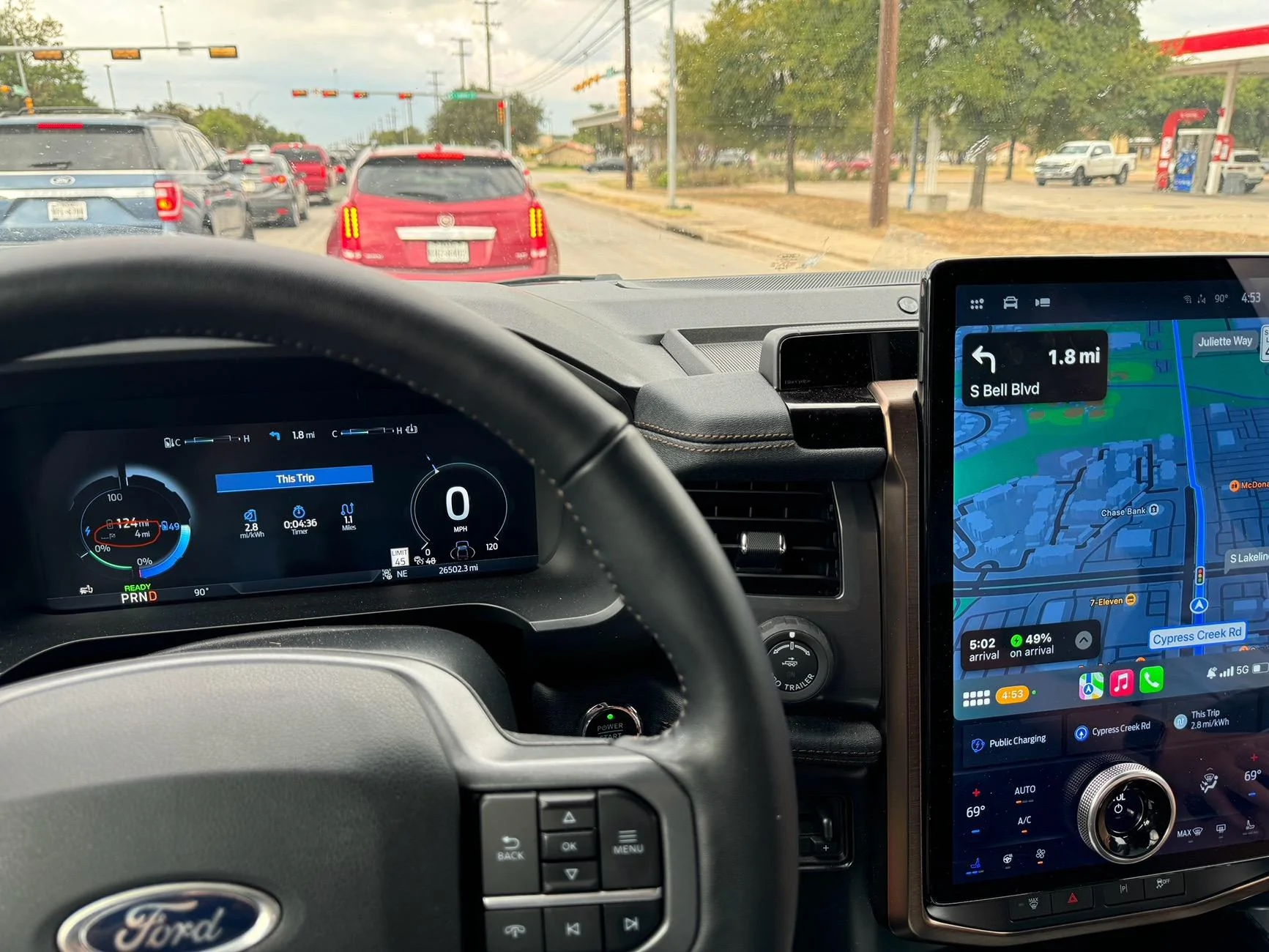

I just noticed that when navigating via Apple Maps, the miles to destination now shows up under the range remaining in the driver’s display, just like it does when using Ford’s Nav. Neat.
That's a big deal for me since Maps doesn't otherwise show the miles remaining and it helps me to mentally keep track of my battery usage along with the app's estimation.
I wish this was an option on Waze.
