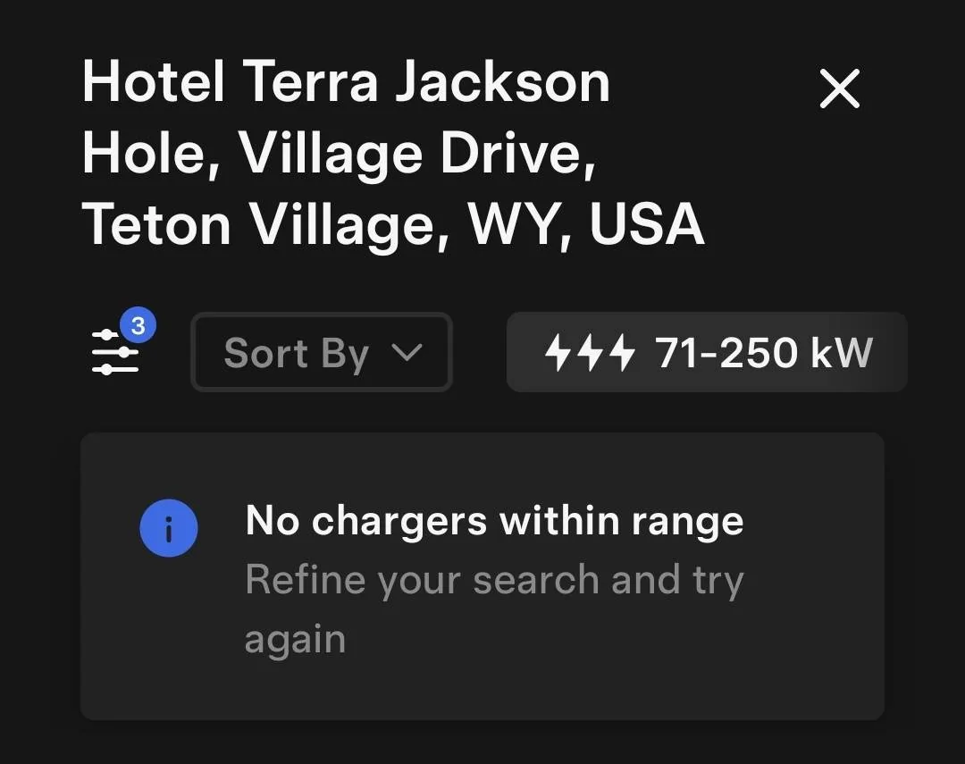

I charged this weekend at a hotel Tesla destination charger that wasn't shown in Tesla app. It worked great! Charged at 9 KW which was fine because I could charge all night for free and was full in the morning.
Attached screenshot from Tesla app for hotel (none shown) that had two destination chargers available.
