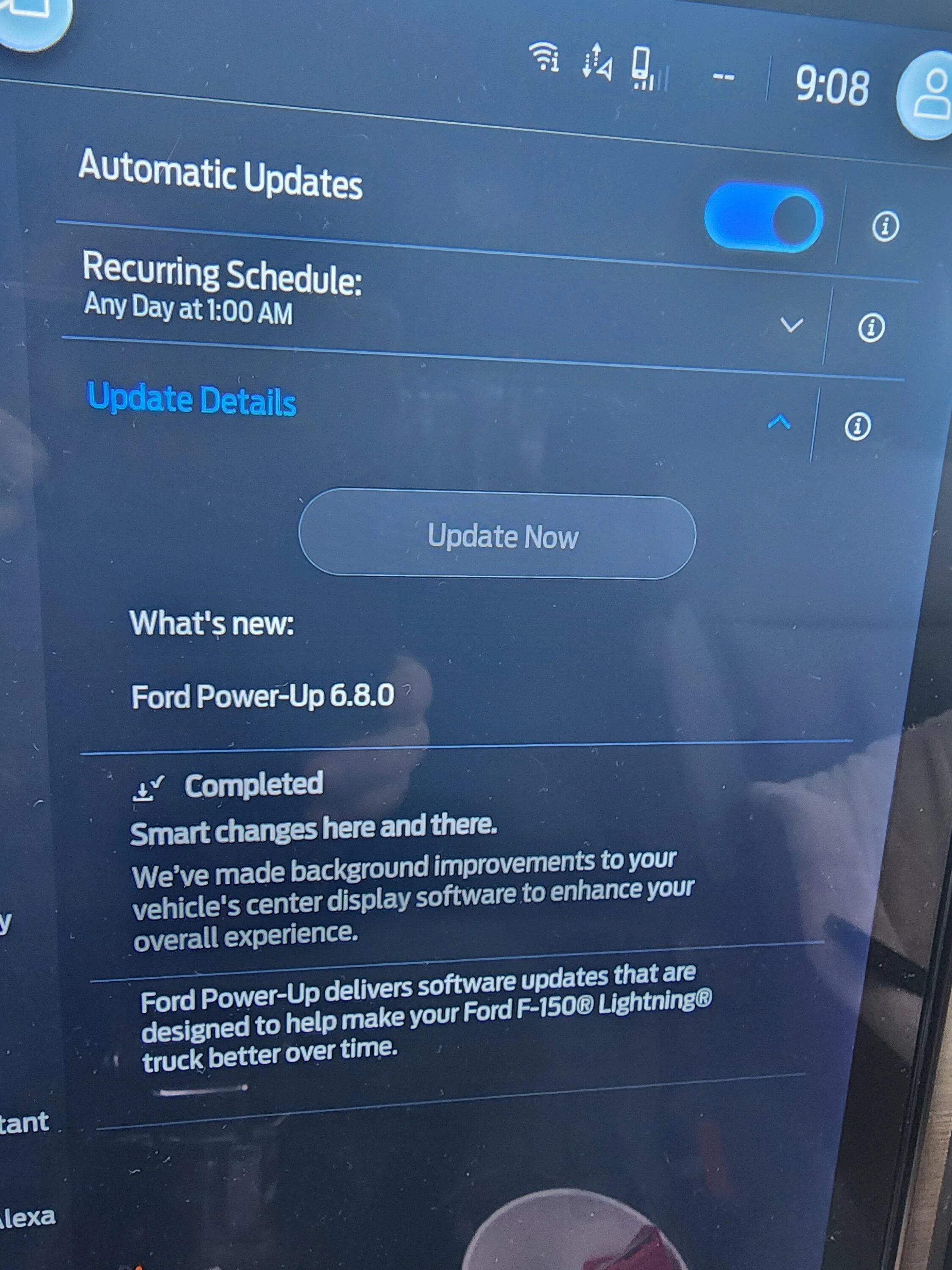

Just recieved and installed 23-PU0813-DOR-UP2 too..
Thanks, my 2023 has a build date 11/23, I bought it in December 23, and it is only on version 4.0.2315 and I have not gotten any updates (like a lot of 2023s).
